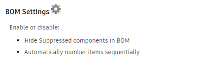

kacper.suchomski
Hi
https://help.autodesk.com/view/INVNTOR/2025/ENU/?guid=GUID-6C58657F-C902-433F-9AA6-22A2ACA09F16

James_Willo
This is a 2023 enhancement, if you are still using 2022 you can only see QTY=0
