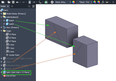

As an workaround:
You could create the part as one solid, create the marks, and then split it into solids (multisolid).
