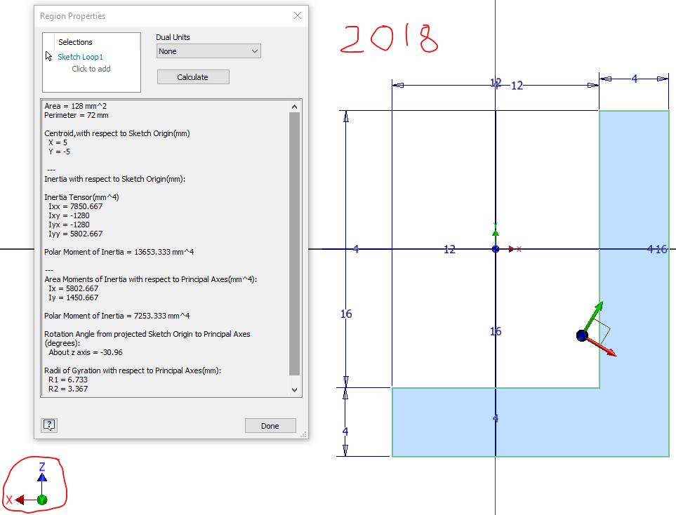

Inventor The 2019 REGION PROPERTIES function gives a wrong principle axis alignment.
The 2018 gives sketch axis and principle axis at correct angles.
The 2019 gives both axis aligned the same.
See the attached screen shots of 2018 and '19
This error is apparent when the function is run on a non symmetrical section.

Message 3 of 16
friskney
Aligned axis [2018]
kelly.young has embedded your image for clarity.

Hi Guys,
Many thanks for reporting the issue! It issue is known as INVGEN-30902 and INVGEN-31298. The latest status shows that they have been fixed in internal build. I am working with the project team and see if the fix can be ported back (some can but some cannot). Hopefully, the fix will be available in the applicable updates soon.
Regarding the wrong values, it is bad for sure. Inventor team or Autodesk as a whole never intends to produce the wrong values. It was a coding mistake like any defect in human-made product. We try our best to avoid a defect and also try our best to fix it when found.

Hi Guys,
The defect has been fixed on 2020.2 update and 2019.4.3 update. Please install the updates accordingly (2020.2 followed by 2020.2.2 or 2019.4 followed by 2019.4.5).
Many thanks!
