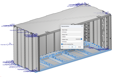

I have a top weldment assembly that has sub weldment assemblies.
For each sub weldment assembies I set representations design view to Default and Associative.
So on the top weldment assembly , sub assemblie's welding symbols disappeared
This top weldment assembly has 52 weld beads
I create a drawing view for top weldment assembly,
I want to show only these 52 weld symbols.

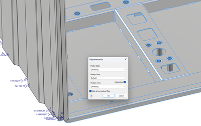

For the drawing view
I set design view option to associative,
I set model welding symbols
but the view shows all top level and sub weldment assemblie's weld symbols..
Even if I do this
result is the same..
The question is; how can I show only the welding symbols of top level weldment assembly, within a drawing view? (52 each only)
