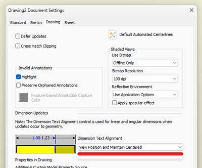

Is it this setting:
Note that it's a Document Setting and will need setting in your template if; a) it's the right setting and b) you want it turned on for future drawings.
