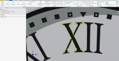

89198826955
the sketch uses
I, X, V
maybe it would be easier to draw them?

kacper.suchomski
Yes, you can sketch them as @Alexander_Chernikov mentioned.
In Inventor this is the best way.
But you can also convert in Fusion.
Inscape / Illustrator also has similar functionality.
