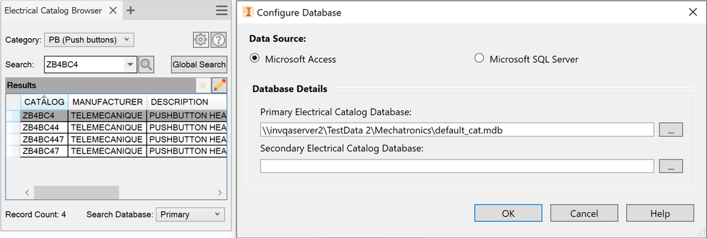

Yes, you need install AutoCAD Electrical or download the full default_cat.mdb, and then specify database manually in the Configure Database dialog in this case.
By default, install standalone Inventor with Electrical add-in will install a light default_cat.mdb (under ...\Autodesk\Inventor 2018\Bin\InventorElectrical folder) but it does not set it as the default Primary Electrical Catalog Database path, and this light database can't be used directly for placing electrical component. This is known issue in Inventor.

JarFu
hi @Anonymous , @Anonymous ,
Yes, the error popup because the database is not set by default. We should fix it.
Have you tried download the default_cat.zip from my previous post, and configured it as primary database for catalog browser? Here is a short video for it: https://autode.sk/3qfWgMl.
Please let me know if you have problem still.

Message 8 of 13
shadowcaster111
That got it running
