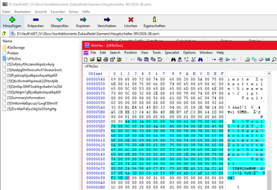

But i have also attached two different .ipj-Files, one letting Inventor open the assembly without complaint, and the other one causing the erratic behaviour that i have just described. This reminds me of a thread here that i vaguely remember, but cannot find again, whose core message was "changing the project changes the file", i.e. the file-reference table of an assembly (or drawing, or derived part) contains some information that is affected by the project file, that is currently in use. I have been aware of this fact for ages, but never understood, how this is supposed to make any sense, as the reference table contains absolute paths for each referenced component.
FYI: The appropriate file has the correct InternalName (I assume, that's what you mean with  "DocID"?) and has been saved the last time with the same Inventor Version  as all other files:
