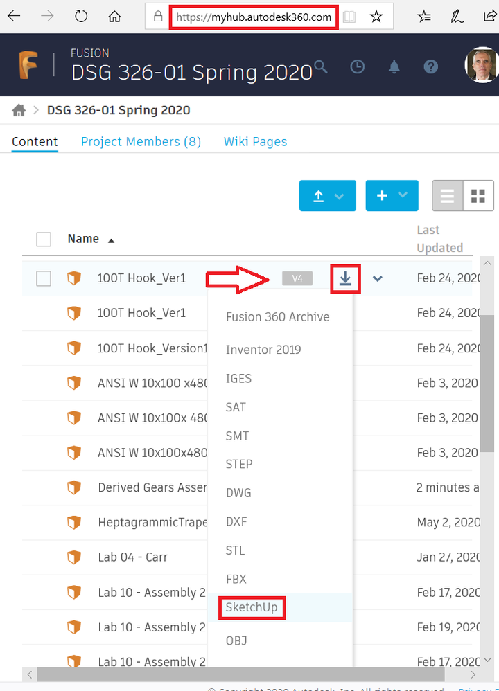

Cris-Ideas
In case anyone is still looking for this conversion.
Fusion 360 can import inventor files and export to sketch-up format.
Cris.

JDMather
It might be worth noting that due to recent changes in Fusion License - this is not possible with free Personal license of Fusion 360..
Otherwise the conversion can be done directly from http://myhub.autodesk360.com
