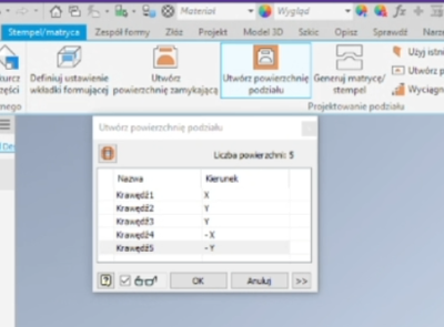

Good morning, I have a problem. While creating a split surface, the additional dialog box that would allow me to confirm the created surface does not appear. How can I find or enable it? Previously, it appeared without any issues.

Do you mean this box?

I have an old screenshot showing this window. After pressing the button to create a dividing surface, the window visible in the screenshot used to appear, but it no longer shows up despite using the Alt + TAB key combination.
