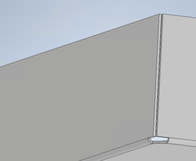

Inventor 2024, is it only me or anyone experiencing the issue where corner seam doesn't work as it should? Please check my video

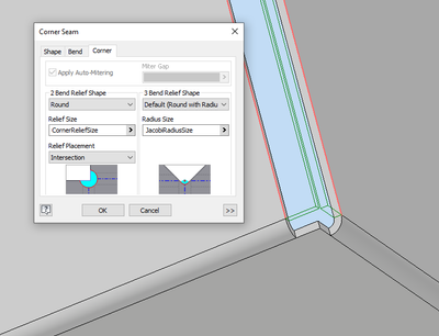

BDCollett
I would assume some other settings like "Minimum Remnant " is overriding the seam.

BDCollett
Something may have changed but it is an interaction between the corner with the original flange and the replaced corner with the seam tool.
Try increasing the gap with the flange tool, the seam then works.
Also, if you change to "tear" for the relief shape, it will work.

@BDCollett Thanks, changing to Tear temporarily fixes the issue, I could not find any other changes in the sheet metal template that used to work fine in Inventor 2023

Facing the same issue. Miter/ Rip/ Seam Gap custom values does not work for rounded, square and trim-to-bend corner relief shapes for INV 2024. Even the overlap not working. Same template settings work correctly for 2023 and older versions.

Quick test between 2023 and 2024.
Flange x2 , Auto Mitre 3mm gap with Arc Weld relief.
Then Corner seam, 0.1mm gap, Round relief.
2023:
2024:
It does not create the seam. The Preview shows that it is there.
There seems to be some inconsistencies and it's hard to test everything.
Message 12 of 14

We have fixed this issue in our internal build. We are planning to include the fix in update of Inv 2024.
Here is how corner seam looks in internal build with this specification:
Flange x2 , Auto Mitering,  3mm gap with Arc Weld relief.

The corner overlap command (Corner edit dialogue box) which is present within the Flange command works as intended.
But the separate Corner_Seam command is not able to modify the overlap.
Enclosing the Sheetmetal IPT file.
