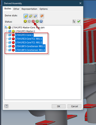

Hello Inventor Community!
My derived parts are failing. I know Autodesk is working on the issue but the given workaround doesn't work. The workaround turns off the associative option under the tab, REPRESENTATION/ Design View.
Here is the workaround that doesn't work for me:
Solved: DERIVED PARTS INVENTOR 2022 - Autodesk Community - Inventor
If you're interested in seeing the failure, check out this screencast:
DERIVED PART ERROR | Search | Autodesk Knowledge Network
Are there other options/workarounds?
How do I find [INVGEN-52392]?
My workaround is to subtract the parts every time a change is made.
Thank you,
-Ethan

ethan_howardMMXXV
I was able to get the workaround to work. Here are the steps:
1. Edit Derived Assembly
2. Click off the Associativity checkbox
3. Subtract the parts
Now if you make changes to any of the parts, the part functions properly.
