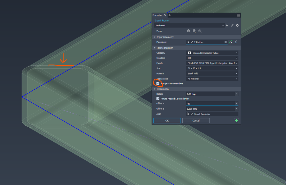

2. I'm checking merge for my profile in order to have a good result but in the drawing I'd like to measure some angles (not in this example) on the end of the cut - profile.
Everything is belongs to these 2 separation lines?
3. How can I easily align my frame(sketch) center.. to the center-point?
Thanks for your support!

@Secttor I wouldn't merge the frames as they will be one part. I do that only where I have a rolled/bent profile like a handrail. Guess you found out how to move the sketch to origin.

Regarding the frame.. you suggest using miter with a very low value? my example is a bit exagerated in terms of value but..

I generally mitre with a zero gap value. If fabricators require a weld gap they can cut it a few millimetres short..
