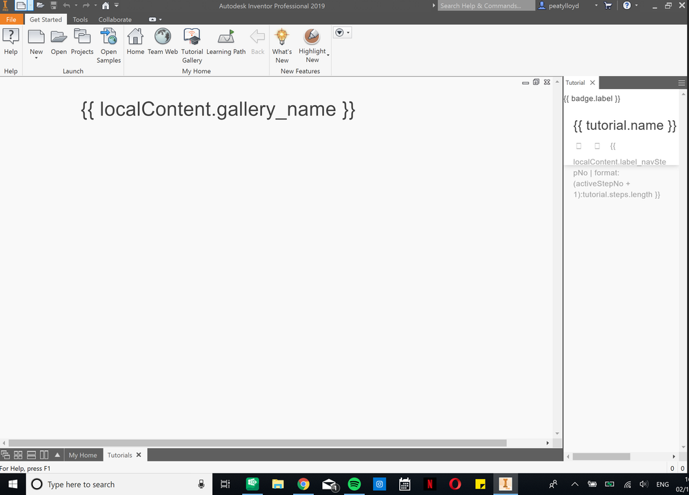

I am running 2019 Inventor Professional with the most recent updates and had the same problem as Matt but after following the solution instructions, in the hope that the same solution would work for 2019, the tutorial gallery still isn't but I have something different displayed. This is after uninstalling the three .Msi files and reinstalling them. Before this I had also tried installing the most recent update and uninstalling and reinstalling all of Inventor.
Any ideas?

The most common reasons for this are the firewall, proxy settings, running as administrator, Repair Install, or Reset Utility.
Do you have an IT person on site that is in charge of this or you can have look into? You can download the files remotely but I think you want the built in tutorials to work.

If the instructions from Kelly and mhackett-tata do not help, please use the Windows Task Manager to see if you have a "C:\Program Files\Autodesk\Desktop Connect\forever\node.exe" task running. If it is not running, that can be why you see both "Connected failed." or "{{ localContent.gallery_name }}" in the gallery.
