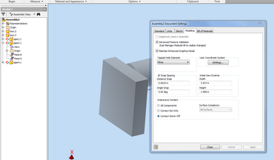

Is the part used adaptively anywhere else?  Try activating the part in place in your assembly, go to Tools\Document Settings\Modeling and see if this box is checked.  if so, uncheck it and see if that helps.

I just tested Chris' workflow above, it works well.
Message 8 of 8
That was not the case, but did like that info, as I did not know about the option. I am aware that if the part is used elsewhere that it will disable the adaptive feature unless you save-as given it another name.
