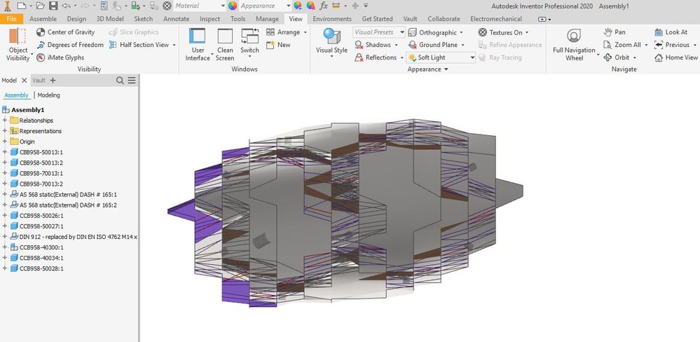

I have an issue with displaying one assembly. It is bizarre that this happens only on this assembly. All parts / subassemblies are correct and display OK when opened separately.
Graphics card and inventor are all up to date, system inf / graphic card details in screen shoots.
Any suggestions?
Thanks.
Tom
903 Views
Sorry forgot to attache the most important the printscreen of the problem.

Hello @Anonymous,
It would be great if you can provide the data to me (xun.zhang@autodesk.com) for more investigation.

Hi Tom,
We need to see the Inventor files. Is the part geometry extremely big or small or very far away from the origin?

Hi Tom,
Many thanks for sharing the files with us! I took a quick look and I did not see the overlapped graphics either. I suspect it could be related your environment. I think you have done it already. But, just to double-check. Make sure graphics driver (CAD mode, not Game mode) is up-to-date. All critical Windows updates are installed. Disable any gaming related graphics acceleration option.
If nothing helps, try a simple test and see if it works better. Go to Tools -> App Options -> Hardware -> Conservative mode. Close and reopen the assembly. Does it work better? If yes, it is definitely graphics hardware related.
