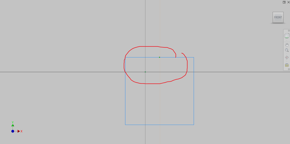

2) sketch point selection (hardly possible to select. Mouse cursor was not captured, but the green dot is like two pixels across)

Hi, have you tried the suggestion made by @blandb ?  From your images that looks like a High DPI scaling issue.  This is very common when switching machines that may have different graphics adapters.

Cris-Ideas
@blandb
Thanks it worked. I can finally select things. Image lost some of its sharpness, but functionality improved significantly.
What I did not understand at first is what icon should I right  click.
For anyone who may also be confused.: So it is right click on the Autodesk Inventor icon on the desktop.
