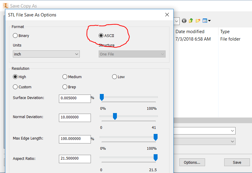

 You can load only ASCII STL files in LabVIEW. Some CAD programs save STL files as binary STL files by default.

TheCADWhisperer
Message 7 of 8
