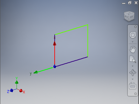

The template is attached. I'm just using the Standard.ipt template that shipped with Inventor 2019. I just installed this version, so I'm 99.99% sure this is untouched. I just realized shortly after attaching this that when you create a sketch by selecting the YZ plane of the part origin, the X axis of the sketch points in the same direction of the Y axis of the part origin. I've dug around in these forums and see that people have been complaining about this for years. Is this going to be fixed? It's highly annoying and counter-intuitive. You can see that the axes are rotated by right clicking on the sketch in the browser and selecting "Edit Coordinate System."
This "Edit Coordinate System" functionality, as it turns out, is the solution to my issue. But really it's more of a workaround than a solution since this is obviously broken functionality. I can think of no reason whatsoever that you would want the X axis pointing up; especially since vertical and horizontal constraints are linked to the Y and X axes, respectively. X is never in any mathematical or cad realm vertical.

Hi! I think I know the issue you are talking about. This is about the way Inventor chooses default sketch coordinate system based on the selected plane. Internally, it has certain rules to pick out the coordinates, which cannot be controlled by the users. As a result, the behavior can be unpredictable. We are indeed investigating a solution to make is more reasonable and intuitive but the solution is not yet available in public releases.
If you want persistent XY orientation, I would suggest you use UCS so that the XY plane is always parallel to the designated plane and the orientation is always Y pointing up and X pointing right.

Attached here is what I'm seeing in my viewport. It's a little hard to read since the drawing axis is centered on the UCS but if you look carefully, the smaller green Y of the drawing coordinate system is in line with the larger blue Z of the UCS and the smaller red X is aligned with the larger Y of the UCS. Are you saying that I have to change the orientation of the UCS?

Hi! I think you misunderstood my suggestion. The workflow I was proposing is to essentially align UCS XY plane to origin YZ plane. Then create a sketch based on the UCS XY plane. In this way, you always have Y pointing up and X pointing right.
If you align UCS to origin totally, the behavior would be the same as on origin planes.

Understood. Still a work around, but at least I don't have to repeat the process for every drawing I do. Just one time for the whole part.
