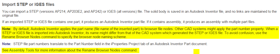

How to solve it:
CCarreiras
WILLIAMF
thanks
i was having the same problem with customer step files.
simple solution
