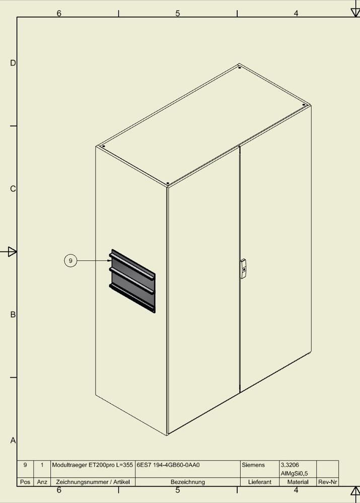

Hello all, I may sound stupid but I want to ask you question.
I have a frame with decals on it. someone before me did the drawings and somehow he manage to make frame as hidden line styles but the decals are as it in model file, colored shaded.
I have attached the screenshot for better understanding of my question.
I check the model file, frame in model file has appearance as "CLEAR". that's it, all other options are normal as default.
 Thank you.

Screenshot of hidden line remove style and what person before me did. Clear can see that reflective warning decals are colored in his way and not colored in what you ask me to do.
Message 9 of 12
bshbsh
This is how I do it:
(note: I just threw in two random parts/assys, I don't have any actual decal, but it should work the same way)
In the assy, set your Frame to BOM Structure: Reference, decal as normal.
On the drawing, set your View to shaded, hidden line removed. On the Model State tab, set Hidden Line Calculation to All Bodies, Line Style as normal, Margin to something big so it doesn't clip away the ref. parts lines.
Finally, on the drawing, find the view in the tree browser, expand the assembly, right click on your Frame and you can select a custom line style, eg. thin lines.
