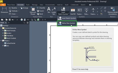

You can create your own symbol library in one as blocks dwg (or idw), and then you can cinsert those symbols (blocks) along your work, they will be always available to insert them quickly, every time you need them:

The library is just a file placed in a specific folder***, where you can find the symbols
You can share it with your colleagues, and they have to place the doc in the same folder in their PCs.
First, you have to create the symbols in a document.
After creation, the symbols will be local in this file.
You can add the local files to a "symbol template" doc.
This file will be at:
C:\Users\Public\Public Documents\Autodesk\Inventor 20xx\Design Data\Symbol Library (or similar)***
Then you have the symbol template available to other documents.
read the Inventor help for this topic.
https://help.autodesk.com/view/INVNTOR/2023/ENU/?guid=GUID-65BD78D6-47EE-4E6F-A617-CD62E77DE73F
https://help.autodesk.com/view/INVNTOR/2023/ENU/?guid=GUID-EF6BFD15-804A-4A9B-A002-C75B61ED6E75

You can save all symbols in the file and share/copy it to colleague to use as Template.
