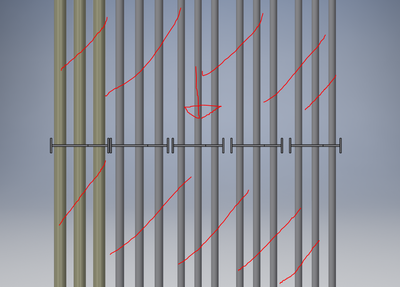

I would like to display a half-section view in the direction of the arrow in the modeling view, as shown below, and a view cut with diagonal lines at the top and bottom. Is there a way to do this?

You need to prepare a cross-section direction reference using constructions elements.
