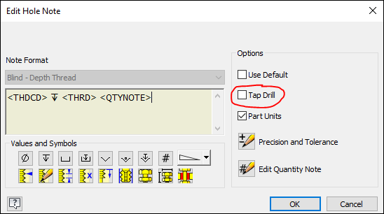

I have a part with a set of holes that have a pilot hole depth and then a smaller tap depth.
I have edited the Style definitions for:
Blind - Depth Thread Tap Drill
But when it comes to placing a hole note in the drawing, Blind - Depth Thread seems to be the default. I'd like instead to have Blind - Depth Thread Tap Drill as the default. Anyone know where this option is in the Styles editor?
I'm aware that I can edit the hole note and check the "Tap Drill" box but my goal is not to have to do this for every set of holes going forward.

Frank.HallWQLC5
Thank you both for your replies. Please re-read my initial post but with the understanding that I have been to this place in the Styles editor and I have made the necessary changes to Blind - Depth Thread Tap Drill.
When I go to the Annotate tab, under the Feature Notes section and click "Hole and Thread", the default selection is with the Tap Drill turned off. How do I have it ON by default? I don't want myself or any of the team to have to remember to add Tap Drill every time they add a hole note.

Frank.HallWQLC5
Thank you so much @blandb! Even with no audio, the little mouse movements make it very easy to follow and your highlights jump out.
In case the video isn't accessible years from now, in order to use Blind - Depth Thread Tap Drill by default when laying down a hole dimension, Blind - Depth Thread needs to be edited - tick the box under Options to use Tap Drill.
And for completeness as @blandb shows in the video and Message 5 above, after clicking Hole and Thread (Annotate tab -> Feature Notes section), check the dimension style being used (Annotate tab -> Format section) is the one you've been editing.
