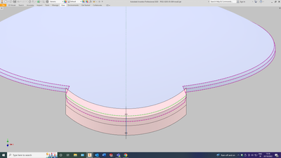

Good afternoon
I have been trying various sweeps and lofts to create some geometry, but can't get anything to work.
Please can anyone help me with this??
Ok so I have the solid which you see below (ipt. file attached).
To explain, please imagine a mobile horizontal axis. One end of this axis is connected to the vertical (in this case y) axis, and so the new axis can pivot around the y axis, but its point of attachment can also slide up and down the y axis.
There is a green "guide" line (3 axis sketch) visible along the leading edge of the "apron". The mobile axis (always remaining horizontal and still connected to the y axis) should move along this guide to slice away the lower portion of the part. As the mobile axis moves towards the centre of the part (YZ plane) its point of attachment to the y axis will slide downwards.
I have tried sweeping a sketch with 2 guide rails, as well as using sketches for the start and end of the modification (see last image below) and doing a loft, but none of these works.
I would be very grateful if anyone can tell me how to do this.
Thanks a million
Stephen

Move cut to center of curve

Good afternoon
Thanks for this.
However unfortunately that isn't what I need. Sorry, maybe my explanation of what I am trying to do isn't very clear, but maybe read it again?
If the modification is correct, and if I then create a vertical plane between the y axis and anywhere on that modified face, and start a sketch on that new plane, the lower line of the cut section should always be horizontal.
In the image below I am looking directly at that end face, and you can see that the bottom line is not horizontal. Rather, the cut is only horizontal in the centre where you have started from.
Stephen

Hi! This is a very interesting Sweep challenge. To keep the cut horizontal relative to Y axis, you need to use Guide Surface Sweep (XZ plane). After the cut is made, Delete Face/Heal is needed to remove some faces. It is because the side faces are not perpendicular to the path. The Sweep cannot clean up the detail geometry. Please take a look at the attached part.

Attached is another file, shown in the image below. I have added 7 axes. All of these pass through the y axis of the part, as well as a point on  the 3d sketch1. These axes are 3.75° apart (see sketch 10). Imagine there were an infinite number of these axes along the 3d line in sketch 10 - all passing through the y axis: this would create the cutting surface I need.
Can you find a way to create this sweep?

Hi! I guess there isn't a great solution in Inventor for this case. The closest I can get is by using Ruled Surface. Please take a look at the attached part. You may need to tweak the angle of the Ruled Surface.
