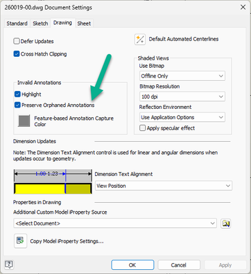

blandb
In your drawing, Tools Tab>Document Settings> Drawing Tab, do you have "Preserved Orphaned Annotations" checked? This should retain broken dims. You will more than likely need to re-attach where they go, but they shouldn't be deleted to where you have to recreate them.

sdreed52
No it wasn't checked and I have now done that. However, the problem isn't so much that they are lost or unattached but that the features are all on the "back" side of the drawing view. The annotations attach but it is to the hidden lines of the feature, which of course isn't acceptable to any cad standards. I can use the view editor to flip the view so the correct face is up but this really messes with the annotations as the anchor points flip but the text portion stays in place. It isn't terrible to fix, just a lot of manual dragging dims and call outs to the correct location.
