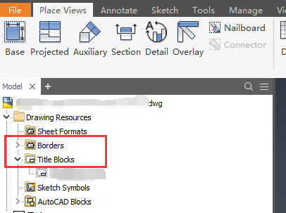

The dwg template file was created in Inventor2023, but I need to use it in Inventor2019. There were some program error when opening the file. How to transition from a higher version to a lower version?

The drawings exported in this way will lose information. The Borders and Title Blocks are all missing, which is what I need. Is there any way to keep them?
