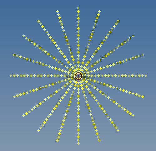

If I'm understanding correctly, you wish to place points (workpoints?) in a radial pattern.  Do the concentric circles have any function other than to define the intersection points?  Why not skip the circles and just make a linear pattern of points in a radial direction, then circular pattern that pattern (see below)?

Hi! If the concentric circles are only for intersection to create the points, Sam's posting is the solution. If you do need to crate the circles for other purposes, you will need to create it one-by-one or use Offset command repeatedly to create multiple circles.

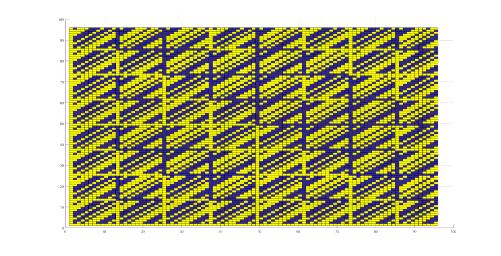

Thanks for the great ideas guys.  I guess I should have thought of that.  If anyone is interested, what I am actually trying to do is map the attached 2 dimensional array to a portion of the surface of the disk.  Actually, to "wrap" it into a "washer" or "2D donut" shape, like represented by the shaded region of the sketch shown below.
Any thoughts on how to least-tediously do that?  I don't suppose Inventor might offer some way of using an array of ones and zeros and some logic to draw a pattern?  I have the array also in mathematical matrix (as opposed to graphical) form.  Could I possibly employ some kind of logical condition where if an element of the array is a 0 then draw a circle (cutout) and if it is a 1 then do not draw anything?
