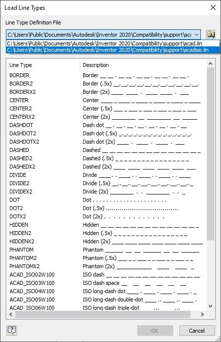

In Style Editor, go to Layer.
Pick a layer on the left.
On right side, edit any Line Type.
At the bottom of the list, pick other.
A dialog popup and there is a Load button.
From there you can select a .lin file.
So I guess it can use any AutoCAD .lin file?

I finally found the Inventor linetype (acad.lin). Your guidance got me started. Couldn't figure out how to access it until you showed it. Never needed it so never really looked at it before today. Great idea!
Here's what I did: I copied InvANSI.lin and went to the end of the file where the 'Fence' and other non-standard linetypes are. I copied all of them and pasted them just above the ones I just copied, and then added a few blank lines below them. Then in that pasted group of linetypes, I deleted all the info that's in the [square brackets] including the [square brackets] themselves. I did that and all the non-standard linetypes showed up in the list.
Unfortunately, the 'OK' button is grayed-out.
Any ideas why and how to get it to work?
Also, any ideas what Setting I can change to redirect Inventor to a different linetype folder?
Duh! I read the Help file and it's right there.
You have to select one or multiple linetypes that show up in the LoadLineTypes window, and the 'OK' button lights up.
Well, it didn't work. None of the SHX deleted characters show up. So deleting those [SHX] text lines didn't help.
