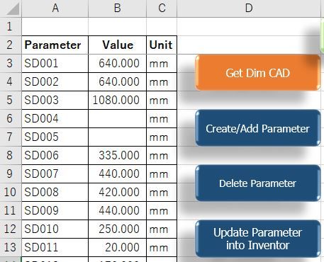

tonythm
Hello @ThyagoVicent
I think, you should use function available in Inventor.
Or you can use below VBA code, I'm really not good at VBA but I can only write what I know.
You can create a VBA that can run multiple .*ipt updates in .*iam.

End Sub
Sub UpdateParam()
