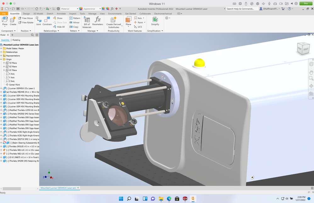

I know that it is a fairly small community of users who are trying to get Inventor to run on Apple Silicon. It is possible with the Windows 11 Preview (for ARM), Parallels 17 (the Apple Silicon M1 version) and the regular Win64 download of Inventor 2020 (mine is Build 168). Inventor 2022 does not work. It cannot display any 3D models. I haven’t tried Inventor 2021.
My problem with Inventor 2020 is that the graphics performance is extremely slow. If anyone has suggestions on how to tweak my configuration, in order to fix that, I would be most grateful.

Have you tried both "Software Graphics" and "Conservative" options under Tools (tab) > Application Options > Hardware?

Message 5 of 8
DhoffmannFFM3X
It had something to do with file system sharing between host OS and guest OS that got in the way. I turned it off like so:
… and ta-da:
