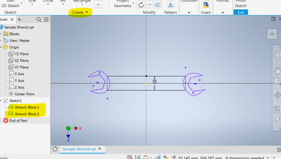

Amit262
Attaching the file..
Amit262
Thanks for pointing to Sketch Block, that seems to be the solution, didn't knew such a thing existed.
So I created a block from the left portion and then inserted a copy of the block and rotated 180. All good so far, but how do I scale it? If I edit the block and scale it, it scales all instances of the block, is there a way i can make changes to one instance of a block? May be disassociate it somehow and make it a separate block ?
JDMather
Create two Different blocks so that you can edit them individually.
In your image you have two instances of the Same block.
I would Edit Block and edit the dimensions within the blocks rather than using Scale.
