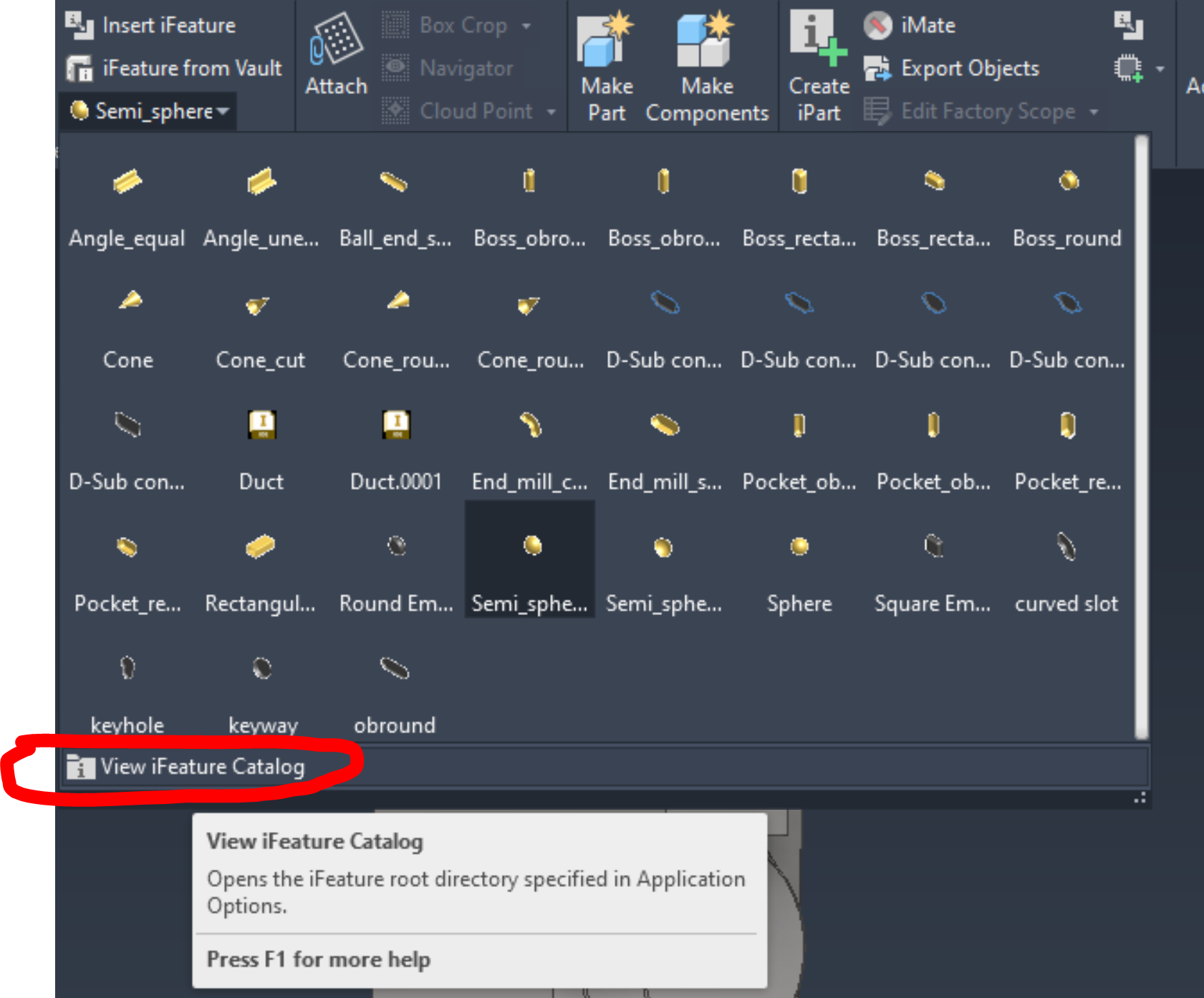

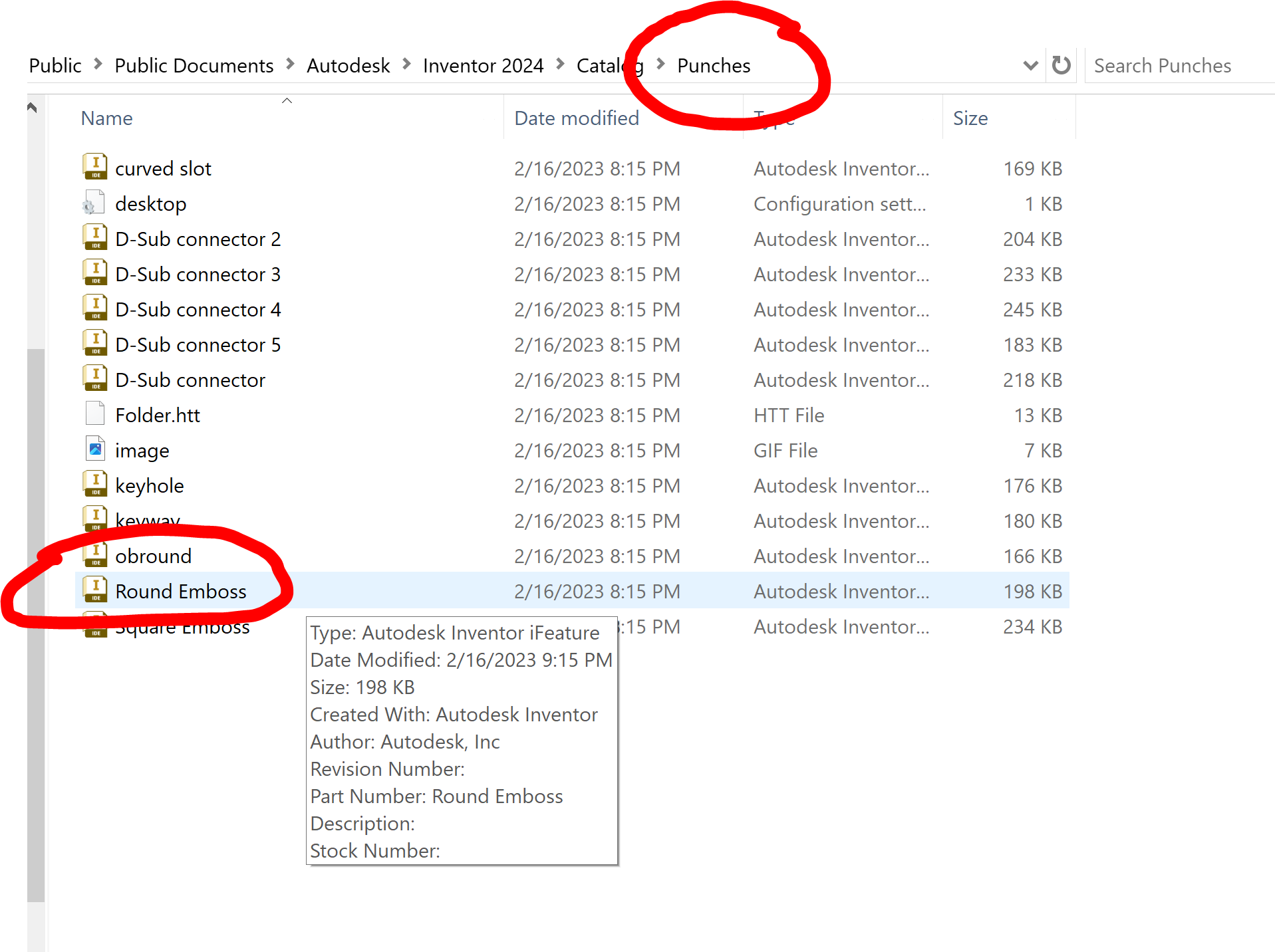

Click the above to open the catalog file listing, then open Punches folder.
Double click Round Emboss to open it in Inventor.

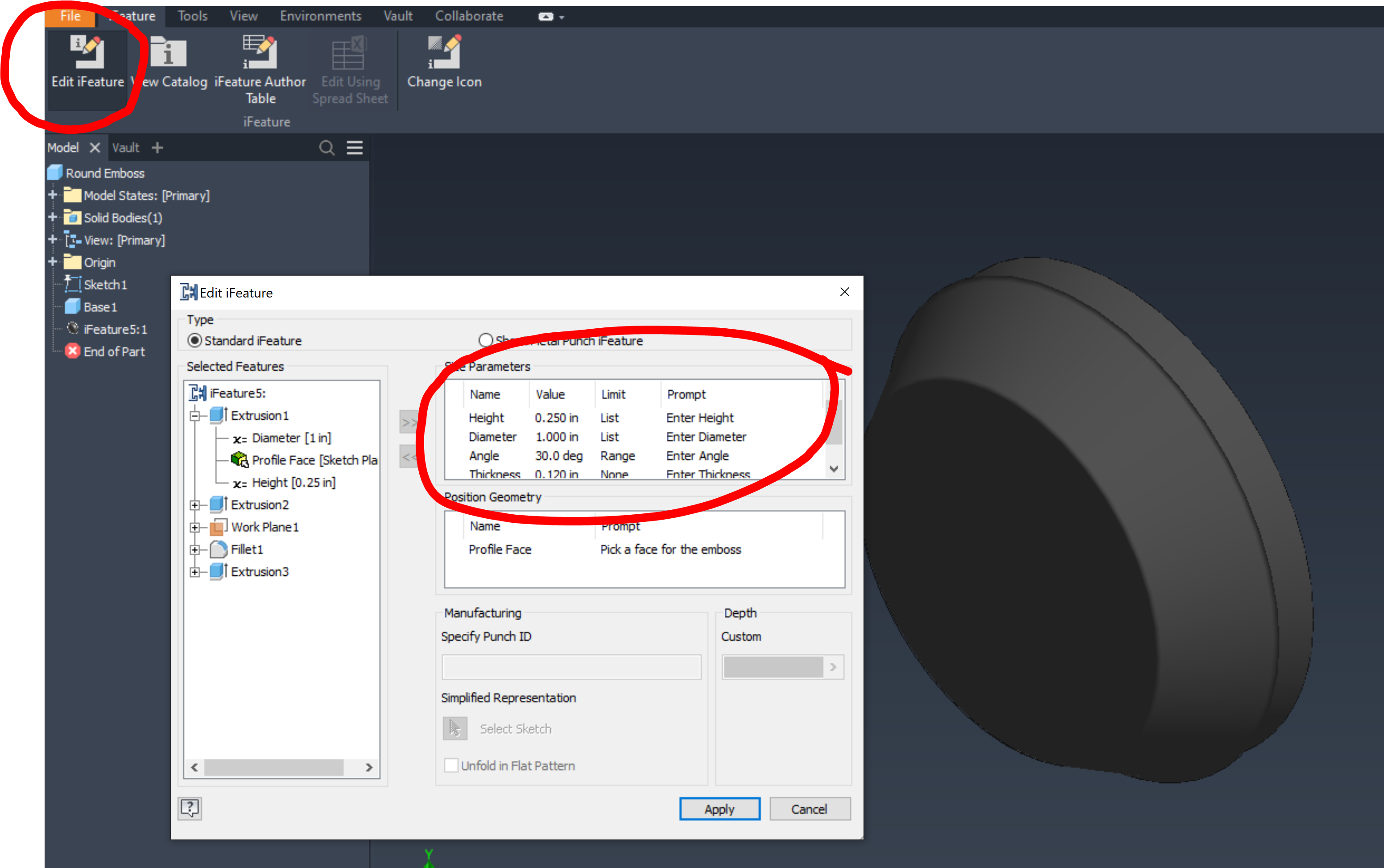

Use Edit Feature, and then modify the dimension as needed, if you want to use Metric, add the unit string mm after the number, as in 2 mm.  Save the feature, and then insert it as needed from the menu.
