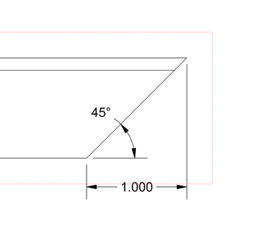

Hi everyone,
I'm trying to dimension a chamfer using the "chamfer note" option from Inventor, but since it is and angle profile that contains fillet, I am not able to obtain the accurate dimension. View from the top, the chamfer that I created in my 3D model creates a split edge when I import the view in the drawing, therefore giving me a wrong dimension. Any ideas on how to fix my problem ? (see image)

mcgyvr
Dimension it without using the chamfer tool... or manually modify it..
Sadly it has these types of limitations as its looking at the actual line in the drawing and does not reference the parts features when it pulls its information..

johnsonshiue
Hi! I must not have followed the steps to reproduce it. I cannot seem to create such geometry with chamfer note like that. Could you share the example here?

mcgyvr
Many thanks!
@johnsonshiue Johnson it looks like the radius on the front part is not tangent to the front surface so that allows the front edge to be selected using the chamfer tool...
This is another limitation of Inventor thats been around for YEARS and needs to be addressed..
Show support for fixing it here..
https://forums.autodesk.com/t5/inventor-ideas/improve-chamfer-note-drawing-tool/idi-p/5031524

Make sure to vote up the idea, but the only workaround I know of in that situation is to change the Chamfer to Distance and Angle so it creates a dimension for the 45° (if it is always going to be 45° you can do just by distance).
Within the drawing you can then link to the dimensions and have them change parametrically with whatever new value the chamfer is changed to.

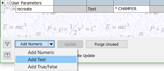

Hi Kelly,
is there a way to save this note somewhere so I wouldn't have to recreate the leader text note every time ?
Thank you

@Anonymous the only thing I can think of is to create an Add Text User Parameter with the suffix you want, for example: °CHAMFER
Then Add from the User Parameter section of the Format Text box.
Hope that helps!
