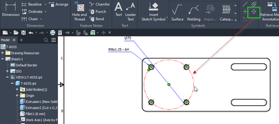

CGBenner
@timothyhwilliams
I think you may be looking for Annotation\Centered Pattern.
Chris Benner
Message 10 of 13
timothyhwilliams
Message 11 of 13
CCarreiras
Ok, now i understand what you need.
First, include the axis you did to center reference the 3D circular pattern:
Now you can use the tool that @CGBenner suggested:
Check it here:
https://knowledge.autodesk.com/community/screencast/163cc202-8c03-42e1-bd7b-bb631d37bc7c

jtylerbc
In addition to the methods already shown, there is also a way to get Inventor to figure out the center of the pattern itself.  Right click the view, and click "Automated Centerlines".  Make sure the option for Centered Patterns is turned on (you may have to turn off some options you don't want as well), then click OK.
