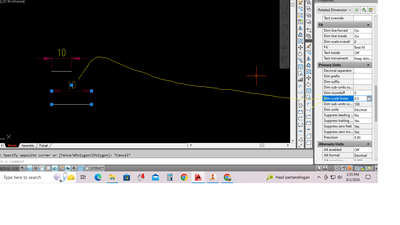

i want to make a part with different dimension. i want change scale a part but it can't change easy like in autocad(properties). if i make new part(inventor), i lost the dimensions.

I just asked. Is it possible to change the dimension scale like in AutoCAD? I think it can happen because AutoCAD and Inventor are from Autodesk.

Dimension scale can be changed in the styles and standards editor. There are loads of settings in here so you need to find the specific one you want. I'm not sure if you're trying to change the size or the actual value.
