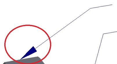

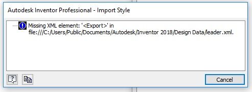

I have a question how is possible to change leaders size in assembly. I don´t have this option in styles editor missing leaders style. When I import that, note appears:

Aha, I checked...it seems like these style in drawing and assembly are not connecting. I tried to import to the styles editor and it not working. So I can´t make it if I understood right. I have this in assembly.
Can you recomended me please any other way how to make smaller leader arrows? because looks really big awful in compare to spiral and container on picture.

I got it, this 3DA leader style missing there. Check this out.
Is existing any way how to put it to the library?
Thanks and have nice day.
