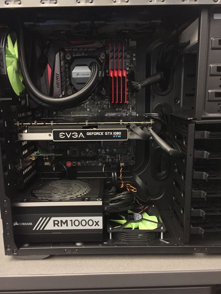

I tested a few different graphics cards today with the 7700K CPU overclocked to 5.1 Ghz.  I also did a couple just for fun.  One with no card installed and I also tested the 6700K with the GTX960 and then again on the 7700K to see the difference when all the hardware was the same except the CPU.
I think these results just further highlight the need for assemblies in the Bench tool.
The cards in the picture are GTX1060 (top), GTX1080 (middle), and TitanX Pascal (bottom).  I was lazy when I took the picture and didn't pull the GTX960 out for the photo.
960.png1060.png1080.pngTItan.pngIntegrated.png6700K GTX960.pngrig.jpgcards.jpg

That is a sexual godly collection of cards, puts my collection to shame! I think though that these results just further prove that unless the GPU is choked on VRAM, it doesn't matter what GPU someone has.
I love a good GPU as much as the next geek but there has to come a point whereby it becomes undeniably obvious that they really do nothing for this application.  I've done the real world tests on a 1000 part assembly, these synthetics fall in line with my testing, you could put this to bed by running OCAT and benching the 100,000 part assembly through the 1080 and the Titan.
If @Raider_71 was able to include assemblies into the next iteration of the bench tool, unless there's a breakthrough in compression technology I would doubt he'd be able to include anything much bigger than 100-500 parts max in a download else his application would end up GB's in size.  That car dataset is 1100 parts and the ZIP file for it is 1.5GB.
