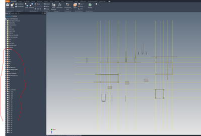

chris
That stinks... because to place all my structural columns in space requires 30+ work planes and 20+ axis's, so my entire browser in full off work features  😞
I can add the current selection to a folder group, but I can't add anymore , reorder or remove any (other than delete)

chris
@pcrawley  They have to be at the assembly level, as those planes, axis's and points are what the added parts/assemblies are constraining to.

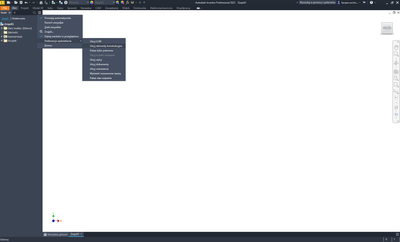

Message 11 of 13
kacper.suchomski
Will it make your job any easier?
Kacper Suchomski
Message 12 of 13
@chris wrote:
@pcrawley LOL, that's exactly how I've always handled it, but when I did my meeting the other day  and they saw an "extra" "file" in the assembly they asked me to remove it and to only have finished geo in the Top Level assembly. I mentioned to them that it's BOM status was set to "ref" and that the part would not be visible, but they didn't like it
They don't like it cuz they don't understand it. I had a boss that was like that. He'd ask me about something, I give him the 10k foot overview (because that's what he insisted of us all) and then he still didn't get it and asked for the details. Give him the details and then he'd complain it's too complicated or that I'm giving him....you guessed it, details. The kicker was, he never had to deal with any of this stuff, he just liked to stick his nose into everything and micro-manage. Honestly, I'd run it past the CAD Admin/Manager, get his buy in as he "should" understand your approach and let him deal with the grief....and I say that as a CAD Manager.
Message 13 of 13
pcrawley
@chris - @kacper.suchomski makes a great point (although it took me a minute to translate it).
"Show Children Only" is a browser visibility setting - nothing to do with object visibility.
Place your grids part file into any/all subassembly and then toggle off "Show Children Only".
When you expand the browser for each subassembly, the children of that assembly are not visible, but the grids are still visible.  Problem solved.
