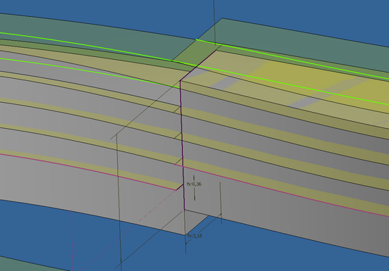

I would appreciate an option within the sweep-feature to avoid self union upon intersection. In the example shown below, that would mean, that the red and green faces respectively the blue and the yellow one would remain single, uninterupted cylinders, and the highlighted edges won't exist
The point is: I cannot model a multi-layer wave spring without gap, because when the sweeping-profile's height matches the helical sweeping-path's pitch, the modeling kernel gets confused with self intersections it can't resolve. Thus, an "ignore"-option would be helpful here:

Hi! Another approach is to split the path into multiple segments. Then create multiple solid bodies so that they don't merge together (see attached part).
A few notes worth mentioning.
- To split the path, the easiest way is to create a surface based on the original path. Then split the surface and use the edges as the path.
- Guide Surface Sweep is needed here so that the profile does not twist along the path.
Many thanks!

Hi! Here is another attempt without creating multiple solids (see attached part). In this one, I created one sweep body. Then use swept surface to split the side faces.

oddly, when increasing the parameter for the number of turns,  Inventor swaps the start end point of the sweeping path, so that the resulting solid extends to the opposite direction. I cannot find an option to control start and end point (which would anyway result in an incorrectly updating model without the user swapping it back):
3Turns - Sweeping counterclockwise3Turns - Sweeping counterclockwise
5Turns - Sweeping clockwise5Turns - Sweeping clockwise
