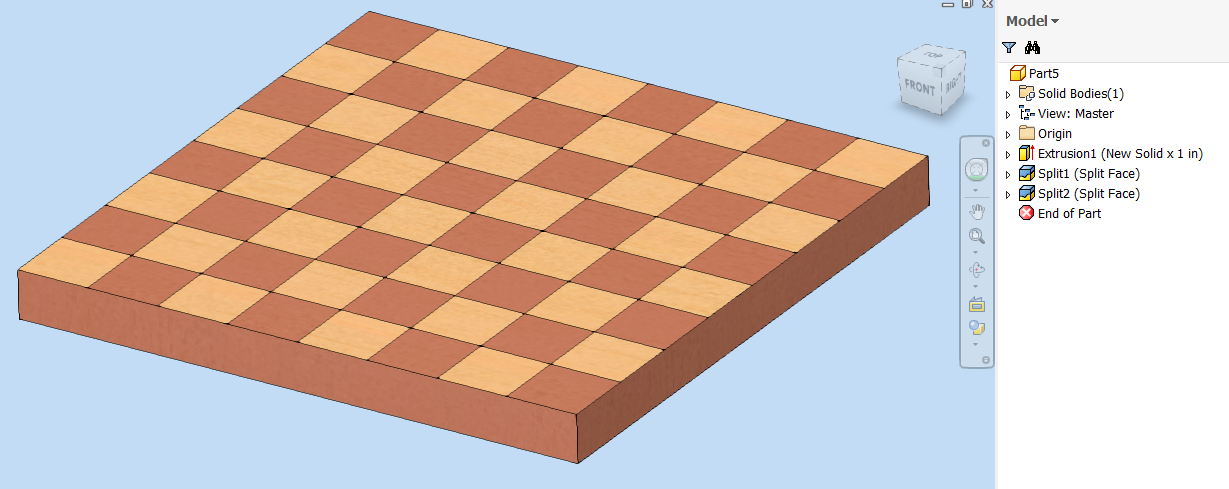

TheCADWhisperer
Attach the *.ipt file of what you have attempted so far.
Are you familiar with the Split tool?

TheCADWhisperer
Took me 5 minutes.
Attach your attempt here.
I think you better ask some more questions before you mark as solved.
I suspect that I used tricks that you haven't been taught.

TheCADWhisperer
Start a new part file.
Start a new sketch on the XZ plane.
Sketch a center point rectangle at the Origin Center Point and dimension 12x12.
Extrude the rectangle in the -Y direction 1inch.
Attach the new file here for inspection and next instruction.
