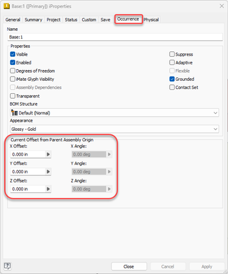

Hello everyone,
I would like to know the coordinates of each of my part in an Inventor professional assembly. Does anyone know how to access this data?

ampster40
right-click on any part file inside an assy and choose iProperties > Occurrence tab and take note of what you see in the X, Y and Z offsets.
