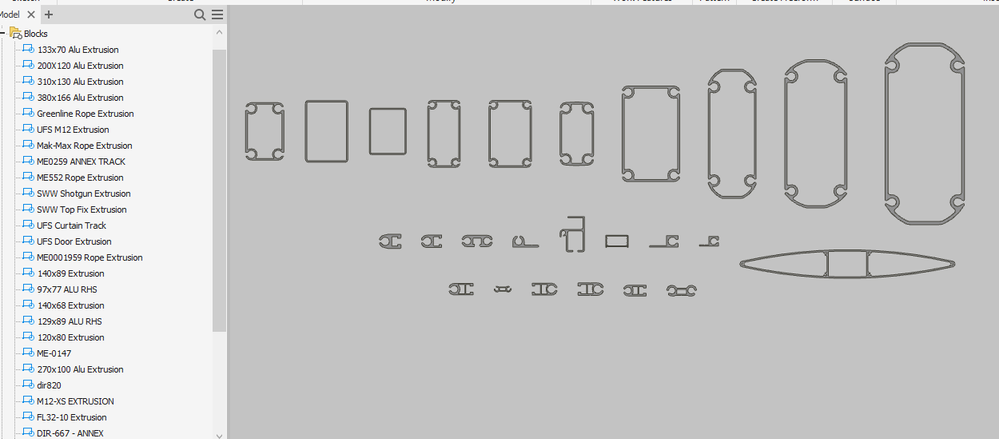

I know you kicked against sketch blocks, but I think you should explore that a little more, reading through your requirements, sketch blocks tick all the boxes.
They can be edited with ease and adjusted to suit a custom configuration, make a copy of the block and add the geometry required to customize each one. Store all your blocks in a library. I don't often derive them, just adds an unnecessary step to the process.
Do not discount Frame generator and the content center either, models can be built extremely quickly and efficiently.
Example of one of my library files, each extrusion has also been authored and is available in the frame generator when required.
