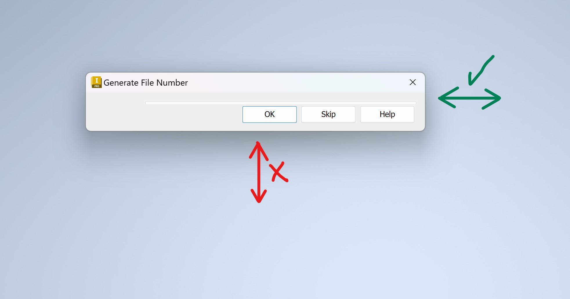

On my laptop I have Windows 11 and Inventor 2023 running. When I go to save an assembly or part the Generate File Number window that pops up for type of file selection and manual input (in this case: Project Number) does not contain anything in it OR it is not scaling properly and the drop downs are not visible. I can stretch the window left and right, but not up and down.
On my desktop I am running Windows 10 with Inventor 2023 and this is working fine. I am assuming this is a Windows 11 compatibility problem. Any ideas?

This looks like a High DPI scaling issue between either the two releases or the two devices.  Try right-clicking on the Inventor shortcut, then open Properties\Compatibility\Change High DPI Settings.  See what that is set for, and try toggling the options to see if any of them get the window back to a normal size in both systems.  Good luck!
Chris Benner
jim.watersZJY2B
Thank you. This worked. I have posted the settings in a screen grab that worked for me.
