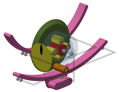

my assembly (parts are derived from the master part bodies):
also here's a video of the working simulation

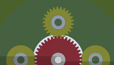

desired result (but it should be parametrically linked to the cylinder geometry):
