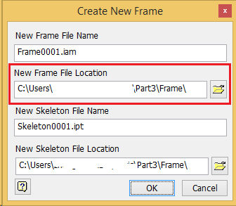

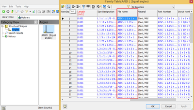

I am building an easy frame with framegenerator, but I there is 16 identical frame members, that I had to change the name when I made them with frame generator.
- How do I change the names of these to be identical? I cant have 34 ipt files in a simpel frame
I do not want these to take all the space in the drawing file / idw.
- Also, I want the ipt files made with frame generator in the main project folder, not in the frame-folder.

Regard the name, it's better to modify the family in Content Center to change the part number before place into assembly via Frame Generator.
Regard to File Location, you can adjust the directory when place Frame Generator. If the assembly is created already, try P&G and place to signal folder.

Regarding the folder structure, there is nothing that keeps you from moving those part files out of the Frame folder (they follow normal Inventor file linking rules, so as long as they are within your project file's Workspace you should be fine).  However, as far as I know there isn't a way to make Inventor stop saving new frame members to the Frame folder.  So if you do this reorganization, you'll want to wait until near the end of the project to avoid having to shuffle the files around again every time you add or change a frame member.
