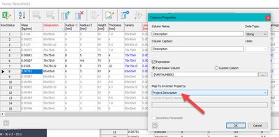

  • Understood on the part number merging - this would be so easy if there were just another check box! So I've added a "description" column that I want to pull the part number, then I'll hide the merged part number column. I thought the right route was to open the content center editor>family properties>template parameters & add it there (see photo) but the description column for that one test member hasn't populated. 🤔 Do I need to open each .ipt to add that to it's iproperties?
(I went along on this route & fear some of our content center practices are not the best.. My coworker uses Inventor 2020 while I'm on 2021, we don't use vault but have a folder containing most of our common members that we've used to publish our structural shapes. We both customize & add to these shapes as needed on our separate machines - I simply customize & publish the shapes I need to my content center - without saving over them there to avoid merging them to 2021. Of course in hindsight they should have been copied & saved somewhere, maybe I assumed they were by being a published structural shape? Phew, I think I have some content center overhaul to do to get it right.. been figuring it all out from the start for both of us!)

Oops, the page had an error, here's that template parameters photo.

If you're saying that you are trying to use the actual "Description" iProperty to act as your substitute Part Number, the problem is most likely that the Content Center Family Table is assigning values to the Description field that are overwriting whatever you are trying to put into the Family Template.
I would suggest using a custom iProperty as the substitute for Part Number, instead of trying to use the Description and fighting with the table.  Alternatively, you could remove the Description property column from the table.

I just found a critical sentence in another thread here.
"After you use the replace family template command only new parts you add will have the additional formatting."
Inconvenient, but okay. A small test model confirmed that is the case.
-Vanessa
(Using Inventor 2021)
Message 8 of 9
jtylerbc
Ah, yes.  That would do it also.  Probably should have asked first - I assumed you already knew that, and that you were seeing the problem on newly-placed parts.
If it was happening on new parts, the table issue I described would be a likely cause.

The "Description" is (possibly) easier to define in the Content Centre Editor.  I typically define all my properties here because it's easy to manipulate.  If you have some properties set in the table editor and some in the part template then it can become more complicated to manage long term.
