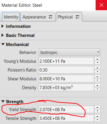

I know frame analysis will not directly give you a factor of safety.  Using the formula FOS = Ffail / Fallow  can we determine the FOS by dividing the yield strength of the material by the normal stress smax number ?  I'm tagging @JDMather  here hoping he can give me some direct help.

Yes.
FoS=Sy/Smax

smax is maximum normal stress, what does sy mean?
Strength at Yield (Yield Strength).

but, Why can't check von mises in result of frame analysis
