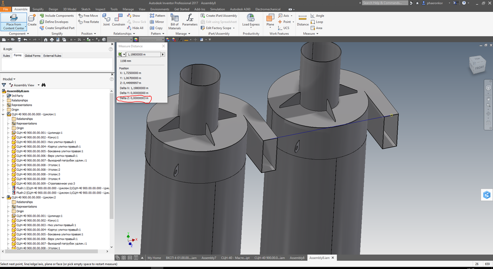

Hello.
Can somebody help me to figure out what is worng with constraint or my asembly?
1. Flush constraint added to assy.
2. Checking distance. And we see that Z axis shows some distance. And how that can be?
I know that number is very small, but it really pisses me off...
Thanks!

CCarreiras
Hi!
I don't have the same behavior as you.
In my case flush gives-me the z=0
Check if you have this option on and disable it:
Check if your flush as an offset in it.

phaeronkor
Hello, thanks for answer!
Try higher precision: 8,12345678. With your precision I have 0 mm too.
Option is turned off.

WHolzwarth
IMO the issue is born in the original assembly, not the STEP.
Two ways for fixing:
- Pattern the fixed sub-assy
- Right-click on misaligned sub-assy-> iProperties -> Occurence -> Set z to 0.

phaeronkor
But I have the same offset in STEP model, not only in assy.

phaeronkor
The last one, R3 update 2017 Inventor Pro.
Of course I don't need such precision, I said about that in my last sentence of a very first post. I just randomly clicked on that precision and saw this, and it's pissed me off)
Message 9 of 9
phaeronkor
Hah, btw you're right! In the occurence tab there was that offset...really strange, cause every cyclone filter was get from one master multibody model and all lefthanded (don't know why while exporting it to step model every cyclone becomes righthanded)  types were misaligned with offset of that number.
