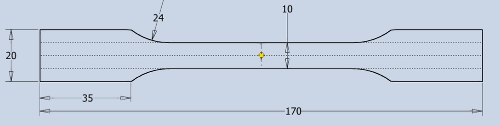

Hey,
For my master thesis is am performing tensile tests on 3D printed materials such as PLA,ABS,... These are non homogenous materials. I would like to model this behaviour as a homogenous material in FEA. To achieve this i try to simulate tensile tests and compare force vs displacement to the actual tensile tests. In attachement you can see a simulation i made. I fixed the parts of the planes that are between campls on a tensile testing machine on one side. On the other side i applied a shear force. However when i look at the stress i notice a high stress concentration on the side that is fixed. Does anybody have a better idea on how to set my boundary conditions?

Has your instructor covered basic sketching?
Issues that I see:
4 failed feature fillets
Origin datum not in logical location
Unnecessarily repeated dimensions
My first sketch would probably look something like this.
How much of the tab on the specimen will be clamped>  The entire 35mm or some portion of that tab?
I idealized my model for analysis (but didn't verify yet).  The layering of 3D printing would result in far different properties.

Hey,
As far as my instructor goes i am sort of on my own due to covid-19 restrictions.
I knew my sketch was not made very good. So i changed it. However i still see a stress concentration on the side where i fix the part.
I think the problem is with this fixed constrained. Any possibilty i could set a force on both sides and work without a fixed plane?
thank you already for your response.
Message 6 of 11
Im sorry i forgot to mention. The sample is centered between clamps with disctance 98mm between the tips of the clamps.

Message 8 of 11
mikejones
If you want to run the analysis by 'pulling' in both directions and remove all constraints then you will need to tick the box shown below to stabilize the model during the analysis since it will have no constraints to fix it in place. I get te following results done this way.

hey,
Thank you for this video.
What i actually dit is apply a shear force on both sides of the sample on parts of the surface that are clamped. So if you messure 49mm from the center of the sample to the outside this part is not clamped. (beyond this point the rest of the sample is clamped) (in both directions ofcourse). The reason i had this stress concentration is because i used a fixed constraint on one side and applied a shear force on the other side. Apparently applying a force on both sides is a better solution (this didn't work before because i did not know how to stabilize my part). I now show results with a smaller deformation then my actual experiment. This means i will have to decrease young's modulus to approximate better the 3D printed parts as a homogenous material, wich is the result i expeted to see.
